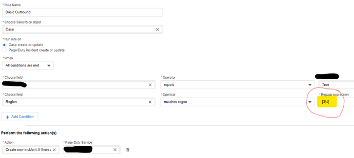

We are trying to use RegEx to compare field values to trigger a PD incident via Rules from Salesforce.
What is the right way of putting rules in Rulesets?
e.g. If the region contains 3 or 4. Tried using [3|4], ([3|4]), /[3|4]
Please share if you know already.
Hello Nishant,
Can you perhaps try using [1|2] again? This does seem to work in my instance. In my testing using 1 and 2 in the description created an incident, but not 3. See attached screenshots:
